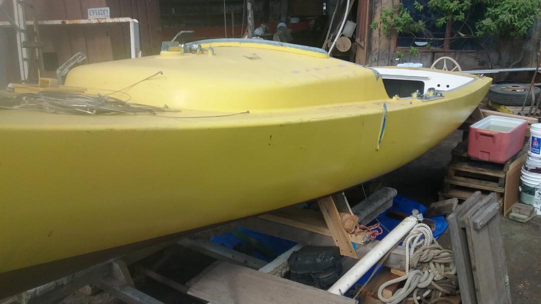

Port frwrd quarter.jpg (68.34 KiB) Viewed 32925 times

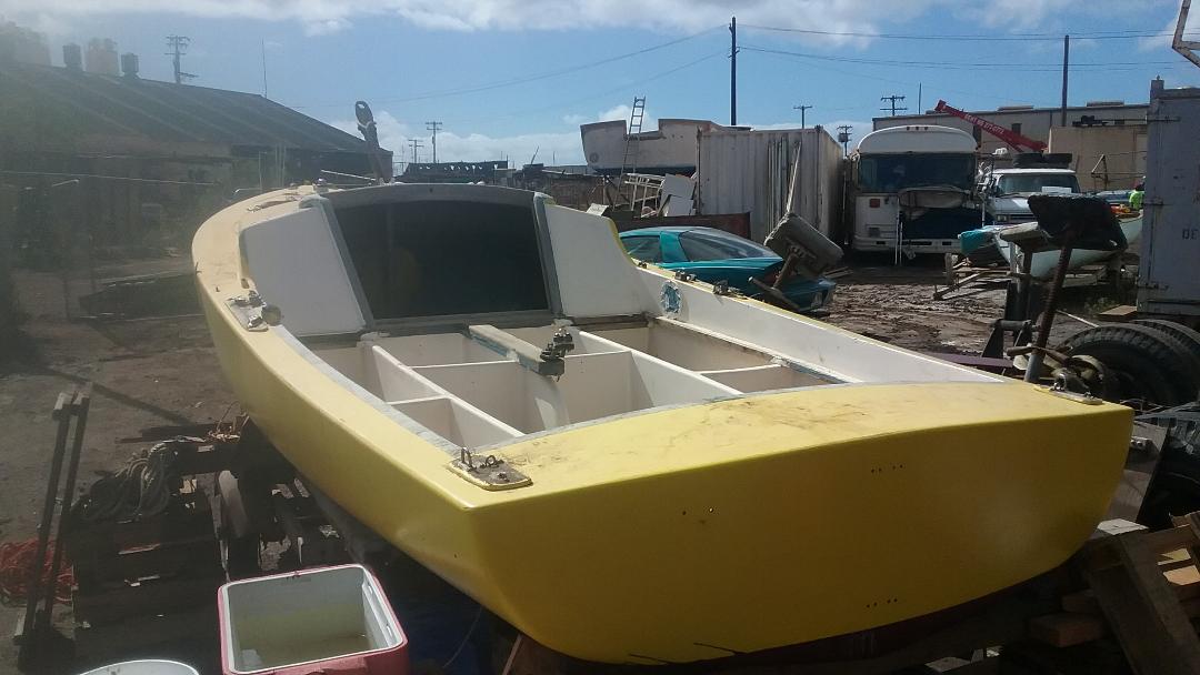

Cockpit and Lounge area.jpg (75.96 KiB) Viewed 32925 times

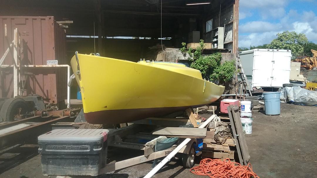

Another pic:
One more.jpg (108.34 KiB) Viewed 32924 times

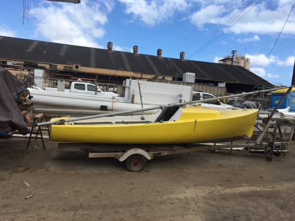

and another.
Yellow Sloop.jpg (36.86 KiB) Viewed 32917 times

Postby TIM WEBB » Thu Jan 11, 2018 1:33 am
Wow, not sure what to tell you. She is definitely a "day sailer", in the generic sense of the term, but might not be a "Daysailer", in the O'Day sense of the term?
If she *is* a Daysailer, she is certainly not a 1989, as boats built in that year (if there even were any?) would not look like this at all. There is an outside chance that she is a very early Daysailer, but has been extremely modified? Hull, cuddy roof shape, and rear deck are where the similarities end.
A number of things stand out as being "different":
- CB lever
- Stemhead and chainplate locations
- Slope of cuddy bulkhead and shape of companionway
- CB trunk and cockpit compartments
- The list goes on!
I really hope you find an answer to you question, good luck!

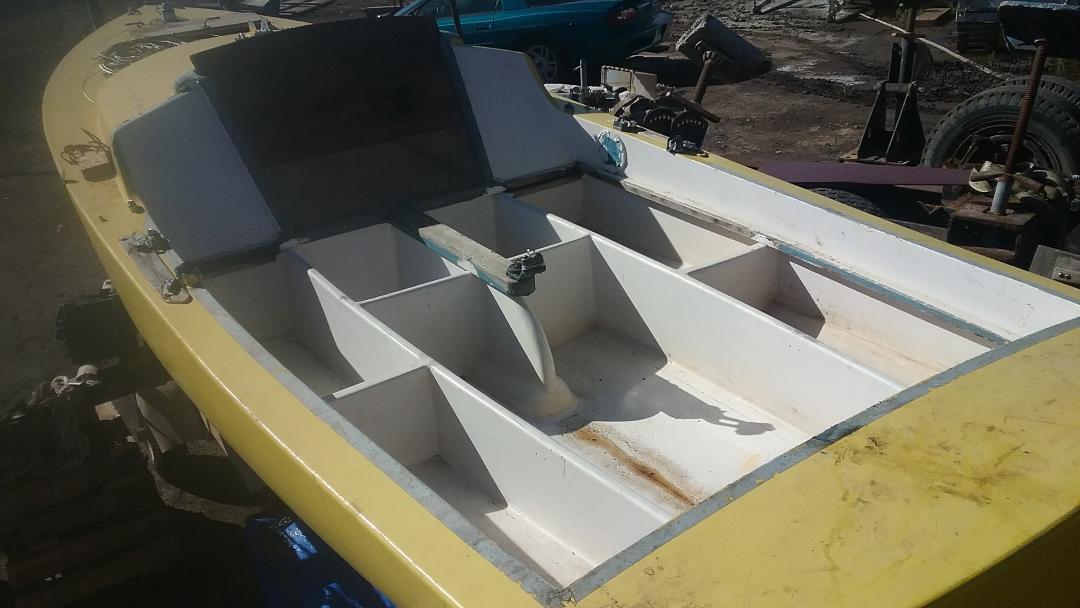

From astern.jpg (76.51 KiB) Viewed 32903 times

Postby GreenLake » Thu Jan 11, 2018 5:58 am
The way the CB trunk is braced with a vertical thwart is something I've never seen on a DS.
Also, the way the back of the cuddy angles does not look like a DS. Likewise the angle at the top of the hull where it meets the side decks. I would expect that angle to be closer to 90 degrees - it's hard to go by visual memory because all standard DS boats have a rubrail there.
While it might be possible for an owner to have removed the rubrail and its supporting flange, that seems unlikely.
Altogether, there's a good chance that this is one of the DS clones (or close competitors).

Postby TIM WEBB » Fri Jan 12, 2018 12:53 am
baggywrinkle wrote:Thanks Tim !
Well I had a hunch she was 'different' when I saw the white part, meaning the cockpit etc. Not complaining, mind you. I like the white part.
Burning question: Does the hull itself seem identical to a DS hull ?
The hull does indeed look very much like a DS hull, but the more I look at the shots of the stern, the more I think that if it *is* a DS hull, it may be a DS3 hull. These versions were only built for a very short time, and are not considered "class legal" because of their higher freeboard aft. The whole deck/cockpit/cuddy configuration is still way different than any production DS I've ever seen. A mystery indeed!
BTW, if this boat does indeed turn out to be a "FrankenDS", and you end up bringing her back to sailing condition, then Rudy will be your new best friend. He used to work at O'Day, knows O'Day boats inside and out, and carries most of the DS-specific parts you'll ever need.

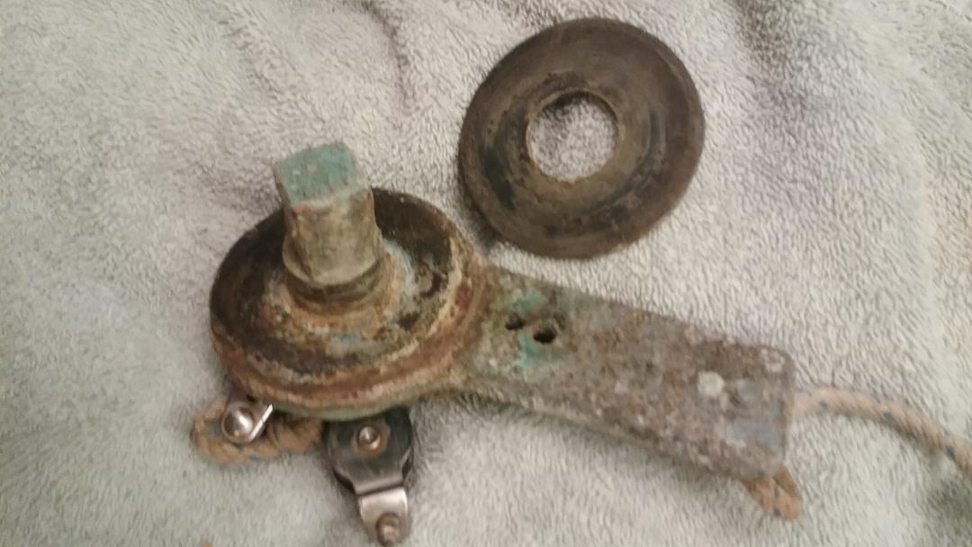

Yep, my new best pal Rudy. He is waiting for pics of the CB handle. I removed it today. Pics below. Rudy's catalog shows a longer handle for DS 1 and Wigeon. But no listing for a DS2 CB handle. Only in Rudy's catalog section for rudders, tillers, and centerboards do I see mention of DS 2 and DS3.
I hope the square lug size matches Rudy's !
My CB operates only by the handle, with tackle attached. The CB trunk has no holes for cables. Simple is OK with me.
Thanks again Gentlemen !
CB handle 3.jpg (79.22 KiB) Viewed 32885 times
Slight angle in handle. Helps protect CB trunk from scraping by operator's knuckles.
CB handle 2.jpg (38.46 KiB) Viewed 32885 times
CB handle 1.jpg (102.24 KiB) Viewed 32885 times

Postby TIM WEBB » Fri Jan 12, 2018 1:55 pm
That is because the DS1, even the current boats being built by Cape Cod Shipbuilding, use a lever for the CB, whereas the DS2 (and DS3 I believe) use a cable/line uphaul/downhaul system, which has its own set of "issues".
But again, your lever doesn't resemble any DS1 lever I've ever seen, but it *does* have the square pin. The CB size and shape would be the same for the DS1 and DS2, but the DS1 CB would have a square hole to accept the lever pin, whereas the DS2 CB has a round hole to accept a pivot bolt or pin.

I wonder how that centerboard trunk is constructed. I wonder is the white liner covering or joined to an inner CB trunk, thereby making a double wall? I realize you guys probably dont know the answer since it is a mystery boat. My reason for wondering is that I'd like to install a pin going thru trunk and CB, aft and high in the trunk, just to hold CB in up position, as a back up. I'll have to crawl under with a good flashlight and hopefully determine how it is built.
Not realizing the angle of the back of the cuddy was a non-DS item, my first reaction was 'nice backrest'....need cushions.

Well, Rudy told me it is a DS1 CB Handle, apparently broken where they usually break, he said. Other than that he said it is probably OK since it already broke. I may replace the missing section with a stainless steel extension, with hardwood grip covering the stainless. Or just keep the block and tackle arrangement which runs aft so one can operate the CB without leaving their seat cushion.
Rudy too said he never saw a DS look like this. Now I want a closer look to see if someone added the white part as a one off, or if it looks more like a production job. Wasnt there a song years ago titled Mystery Ship ?
