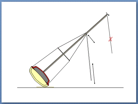

The mast needs to be up and the rig tensioned, but if you aren't sailing, you wouldn't rig the boom. If you are out on the water, you'd secure the boom with topping lift and mainsheet.
When you have the boat beached or on the ground, you take the jib halyard or spinnaker halyard and pull sideways. If in shallow water or at the dock, you may need a helper to hold the boat so it doesn't just follow your pull. Once you get the hull to rotate, it will get progressively easier to counteract the righting moment. With the boat horizontal, you can tie the halyard off to a concrete brick or a bucket filled with sand and it will hold the mast down.
Note that the diagram shows the jib halyard and not the main halyard. The reason is that the main halyard exits at the top of the mast, which is unsupported. This is of particular concern when you have removed or no longer have the jumper stays. (They aren't needed otherwise, so it's fine to remove them, just be aware that you then can't use the tip of the mast to careen your boat).
The jib and spinnaker halyard sheaves are near the point where the shrouds meet to stabilize the mast. If you pull at that point, the loads get taken up by the shroud and you don't end up bending or breaking your mast. That's the reason you want to make sure your mast is properly supported and the rig tensioned before you careen your boat.

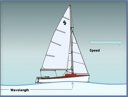

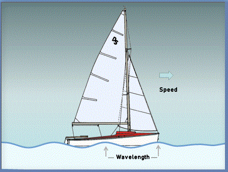

The bow wave that the boat produces has the speed of the boat. That first wave crest, after all, travels with the bow. Now, one interesting feature of surface waves on water is that longer waves go faster (and shorter ones go slower). That relation holds even if you create a wave of a given speed: the faster the bow wave, the longer the distance between crests, or its wavelength.
On a day with variable low winds you should be able to observe that the tiny ripples that your boat makes when it barely moves are much closer together than the bow wave once you get going.
Also, as you speed up, more and more energy is needed to create these faster waves. At some point, skin friction becomes less important than wave drag and your sailing technique adapts: it’s faster to sail the boat flat.

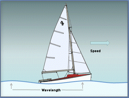

If you end up going so fast that the length of the bow waves becomes twice the boat’s length, your stern is in the trough and the bow rides up on the crest. You literally sail uphill. As you approach that speed your wave drag goes up very rapidly to the point that you stop going faster from just a little bit more wind. This limit to your speed is the hull speed. Because it depends on the wave length, which is related to the speed by basic physics of water waves, your hull speed depends on the length of your waterline (or rather, its square root).
Hull Speed Limit
The formula is Hull speed (in knots) = 1.34 * Waterline (in feet). For the DS that works out to about 5.4 knots. This is an idealized value. Hull shape has some effect and you’ll find that you can push your DS to a bit over 6 knots while still basically in displacement mode. Some people call this extra range the “forced mode”. (The exact figures depend a bit on the hull shape's "prismatic coefficient".)
As you approach hull speed, you’ll notice that there is also a pronounced stern wave and that the wake you are leaving behind will begin to look a bit like that of a powerboat. These drawings are too schematic to capture those details, go out on the water and observe. Try to accurately guess your speed through water based on the wave system.

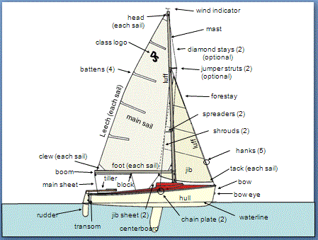

There are particular names for the many parts of a boat and which form part of the terminology used in sailing. Many other discussions of basic concepts lead off with them, but that can be overwhelming. However, now that we have seen much of the basic concepts in sailing, it is useful, if not overdue to put it all together in one place, so here's an annotated boat outline with all the parts marked.
Names for hull and rigging
Not shown are the jib and main halyards. Those are the lines that raise the sails. The three corners of each sail are called head, tack and clew, but only one example of each is annotated. Where a number is given in parenthesis, it shows how many of each item can be found on a DaySailer. For example, there are two spreaders, one on starboard and one on port.]
Also not shown is the vang which is a diagonal purchase going from the mast partners on deck to the forward quarter of the boom and used to pull the boom down. Then there are the additional sail controls: the Cunningham (pulls down the luff of the main a few inches above the boom) and the outhaul (pulls the main sail clew back to stretch the foot).
Finally, one of the mainsheet blocks is annotated to illustrate the term "block", but there are, of course, a number of them on board. None of them is ever referred to as a "pulley".

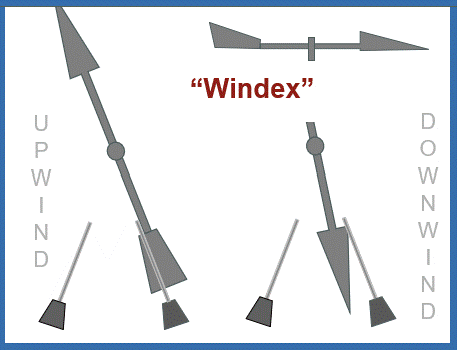

A mast-top wind indicator, often called a “Windex” after a popular brand, is an arrow shaped pointer with a broad tail to make it easier to view from below. A reflective sticker on the bottom gives visibility at night. The pointer rotates freely and always points in the location of the apparent wind. There are two tail tabs that can be positioned to mark the expected position of the pointer when sailing upwind on a close-hauled course. If the tail is between the two tabs, the boat is pointed too high into the wind.
When installing the wind indicator, the tabs should be bent far enough apart so that they reflect a realistic upwind wind angle for the boat. Trying to sail upwind on an unrealistic heading leads to “pinching”. The boat appears to point upwind, but leeway increases so that the actual course sailed is less advantageous and, in addition, the boat slows down.
In some conditions, it is safe to point a bit higher; by looking closely at the overlap of the tab and pointer, it is possible to read off small differences in the apparent wind direction.
Masthead Wind Indicator (aka "Windex")
On a reach the indicator will point off to the side, with 90 degrees often considered to mark a broad reach. When sailing with a spinnaker, this usually defines the limit; if the wind comes from any further forward, the spinnaker will no longer set.
When running before the wind, the Windex is essential in preventing an unintended gybe. Any time the pointer is between the two tabs, particular care should be taken. The mainsail will tolerate wind that comes a few degrees beyond the midpoint from the lee side. This is called sailing by the lee, but it is not a stable condition. It often ends with a crash gybe.
