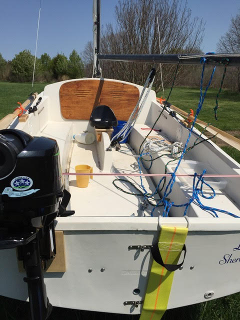

Here is a picture of what the former owner installed on my Daysailer II. I have since removed. I think the seat and oarlocks worked well for storing the oars along the deck.

Alright, I'm curious. What's the black thing mounted on your center board trunk?

That is the rowing seat. It was a plastic chair seat mounted on a wooden base that strattled the centerboard trunk. I never sat in it but it appeared to be quite sturdy and it did not damage the trunk at all. The oarlocks were mounted with 4 bolts to the top of the deck combing. The access ports were for access to the fasteners.

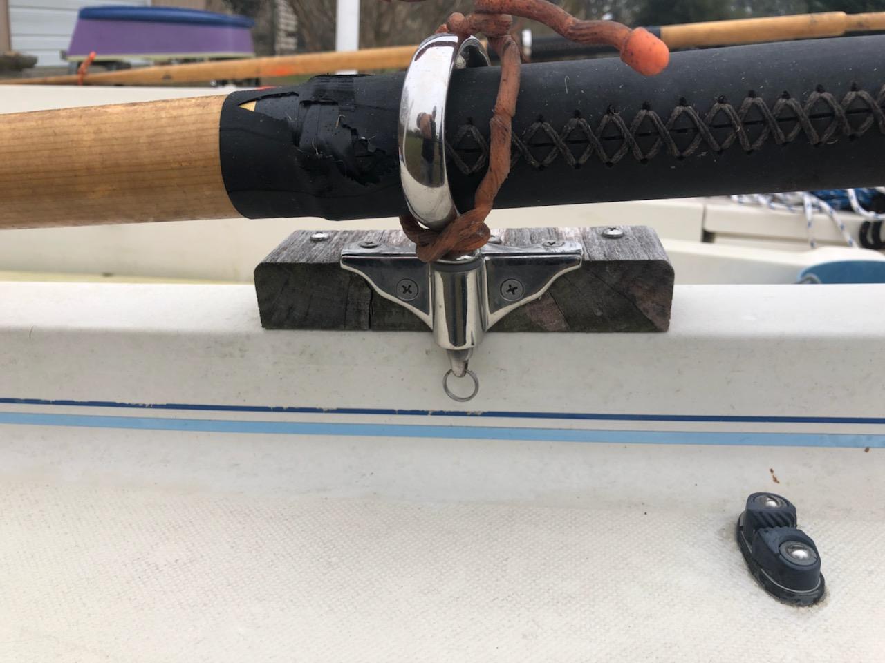

Postby Slim » Fri Jul 09, 2021 10:39 am
Jeez! I thought it would be a pretty simple project to make a couple of oars, but months later, still not there. Just finished the oars themselves. Now to figure out oarlock positioning and attachment, a rowing seat on the centerboard trunk, and some leathers for the oars.
The oarlock postioning will be the toughest- two potions seem to be up against the coatings on a wooden block and more outboard closer to the rubrail. Because of the length of the shank of the oarlock, it will have to be higher than I’d like-pain in the butt when hiking out. Definitely need to rig a temporary moveable block to try out different positions.

Postby GreenLake » Fri Jul 09, 2021 6:29 pm
The length of the shank of the oarlock should not enter here.
I believe you may have made the assumption that the shank needs to remain above the deck, but why should that be? There's nothing that prevents you from splitting your oarlock horizontally and fastening one half above and one half below the deck (with a hole drilled so the shank can pass into the space between deck and seat).
Incidentally, this would work well for removable oarlocks: if divided into two pieces, you can throughbolt them together. It would require three holes in the deck: for the shank and for each of a pair of bolts. You could even set up multiple positions, with a strip of 2" electrical tape to "cover" any unused holes.
I'd be curious to know if the over the deck position is the one you prefer compared to one inboard of the coamings?
Finally, there's also the option of mounting a wide enough triangular base on the deck so the shank position is outside the rubrail. Perhaps that's the one you meant? That one should be removable as it interferes with docking, but might be ergonomically even better?

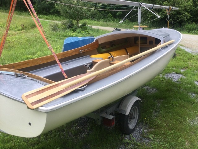

Are those flotation bags under the cuddy? How are they strapped in?
Re: 10 foot oars
Postby Slim » Mon Jul 12, 2021 9:03 pm
The flotation bags are inflatable beach rollers from duckworks. They are ultra tough vinyl that you can supposedly roll your boat into and out of the water with (haven’t tried it yet). Also can be used as dock bumpers and as entertainment for the kids! However at 5’ long they fit perfectly between the seats and forward bulkhead. As part of a major interior overhaul I gave my boat this winter, I epoxied some D rings to the hull with a short piece of nylon strap. I figured as long as I was going to be toting these things around they might as well give me some extra flotation...
