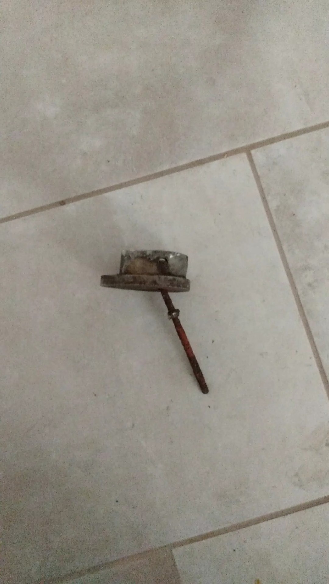

The attachment bolts holding my mast step casting in place at the bottom of the compression post have deteriorated. As a result the compression post had too much wobble causing my new mast hinge(tabernacle) to buckle and fail when I single-handed the mast up.
To remove the casting I notched an opening around it with a dremel and then drilled out the rusted attachment bolts.

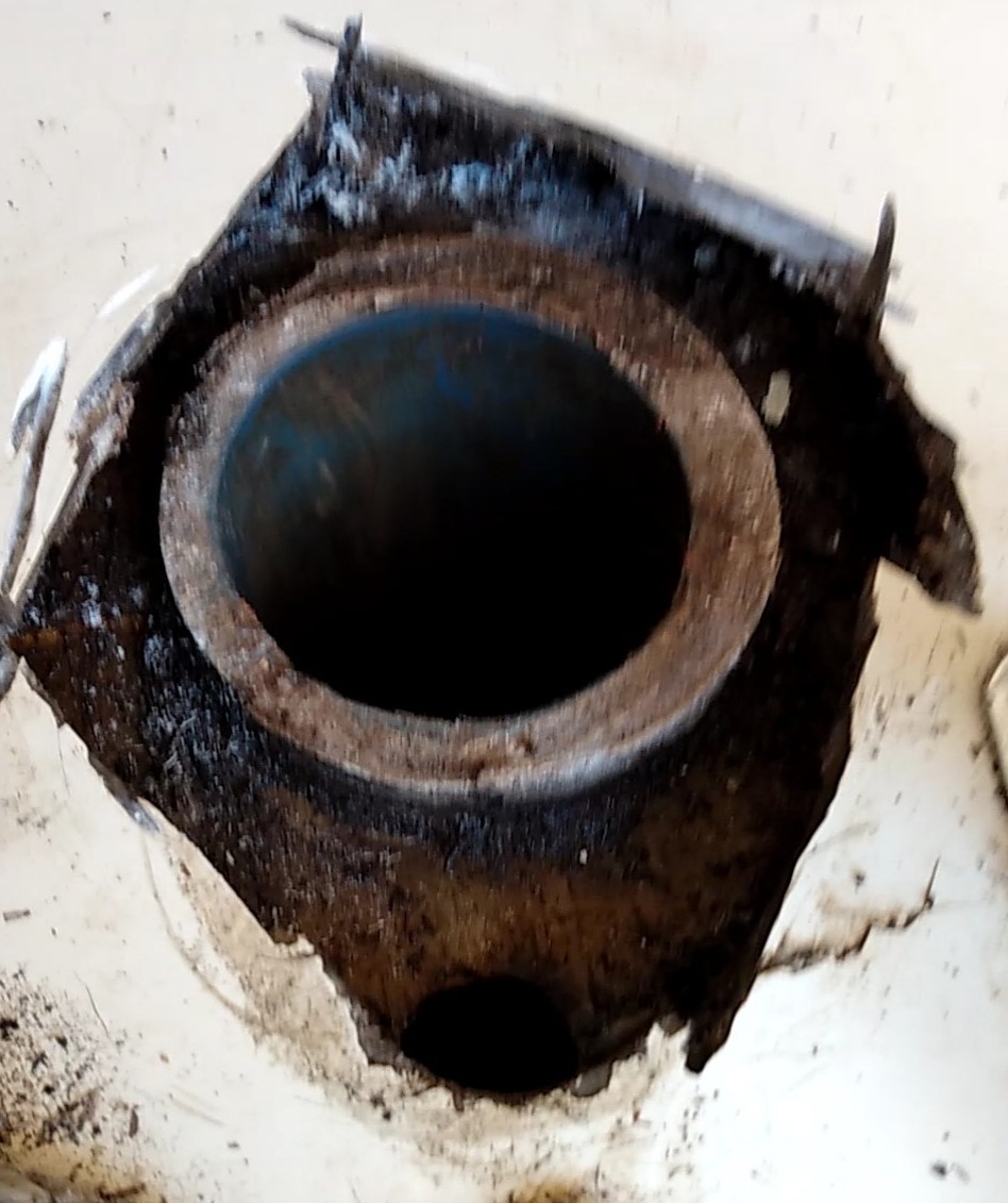

The tubing shown here is what is left below the casting.
Can the casting be re-attached by drilling into the surface edge of the tubing and screwing the casting into place?
Or would it be necessary to tear the cabin floor apart and go from there to try to find what and where the old attachment bolts were attached to?

On my boat there are two sheet metal screws holding that casting in place. I didn’t do any surgery there so I’ve no idea what is under the floor but it felt like wood and/or FRP and I don’t believe I have a tube like you have.
Either way, if I understand correctly the bulk of the force there would be downward, so the screws would just keep things in position. I would then think that a few screws into the tube would be ok. Or maybe you could bond some aluminum or brass plate to all that to accept the screws.

How you meet these conditions is somewhat up to you. If the support column is still in place (and in the correct location) you can use it. Other owners had issues with the support being off center, but that does not seem to be the case here.
I can't quite tell were your rusted out bolt was attache previously, but anything you might work up that results in the mast being fixed horizontally (and held down against any temporary pull upward during mast raising) would be fine. The floor (after you restore it) should be strong enough to support the mast in the horizontal direction. While the upward force on the mast during raising is less than the compression load it may be marginal to rely on the floor, but perhaps not.
However, it's difficult to diagnose some stuff from pictures. You may be better placed to know where to anchor any new bolts (and or where to maybe construct an anchor from an angled piece of aluminum glued to the compression post or a blob of fiberglass. I don't think you need to either drill into the compression post or reconstruct the precise method that was used before.
