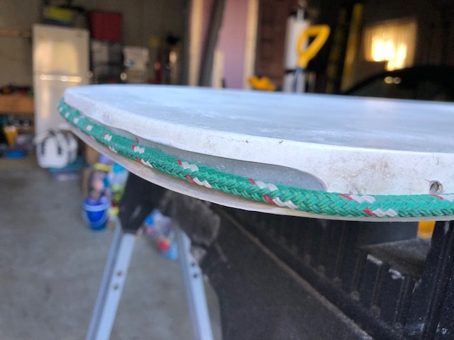

Adding my experience to what seems to be the single most discussed topic on this forum. As mentioned in my recent shakedown sail report (https://forum.daysailer.org/forum/viewtopic.php?f=2&t=6158) the biggest issue I had was the CB downhaul line jamming between the CB and inside of the trunk.
My DSII is a '72 and the downhaul line exits the top of the CB trunk near the horn cleat. When lowering the CB, this puts a lot of rearward pressure on the downhaul which causes it to "derail" and jam every single time. Pulling harder on the line only causes it to jam more and once set. Once jammed, the CB is virtually immovable. Note the that the SS uphaul line and tang have a relatively straight run and don't seem to have any issues.

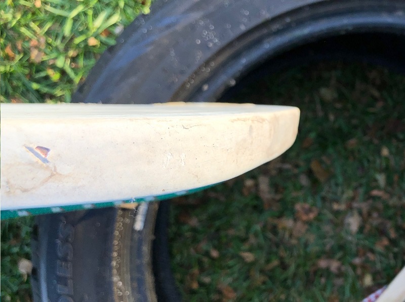

After inspecting the CB I noticed right away that the "top" of my CB that the downhaul wraps around is not level but actually tilts to the side. This appears to be a defect in the molding but definitely encourages the downhaul to pull to one side under tension.
View of the "top" of the CB - uphaul line is supposed to wrap along this edge when CB is up
Having the downhaul routed towards the back of the trunk top seems to have been a poor design choice which encourages the line to pull "into" the CB rather than "away" from it.

In the end I decided to grind the leading edge level and carve slot into the CB. By carving directly into the CB, I wouldn't have to worry about adhering more material. I was also a little worried about clearance inside the trunk.
I started with an electric palm sander and an 80 grit sanding disk. The sander chewed through the gel coat and poly really quickly. The edge was level in only a few short passes.
CB edge sanded level (approximately)
Under the gelcoat you can also see the filler holes for what I presume are steel stringers that run down the CB. Most importantly to me, there was not core in sight and everything still looked water tight.

Now that the board was level, it was time to cut the groove. I used my dremel with a 3/8 sanding head attached. Then using the downhaul line as a guide, masking tape was used to mark the channel. My goal was to run the channel across most of the top of the CB from the uphaul tang down to the downhaul attachment point. This was the primary area where the downhaul was derailing.
Marking the groove to be cut
I cut the channel free hand using the tape and my eye as a guide. The channel was about 3/32" deep which seemed sufficient for the downhaul to have a seat. Was afraid that going deeper and putting too much stress on the CB edge.
Test fitting the downhaul
