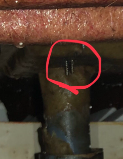

I have a 1982 DS II and noticed a fiberglass crack in the cuddy right in front of the mast step. I took a picture from the cockpit access hole and found that the two screws holding the mast step (circled red in the picture) are not even directly over the compression post. I've heard this is a common issue on the DS II, where the compression post is not directly lined up with the mast step. How can I fix the fiberglass crack, and do I need to move the compression post as well?

The pictures aren't 100% conclusive. There appears to be a square plate below the floor and the screws seem to go into it, that should normally be enough and not a cause for worry. Since you seem to have an inspection port from which you can take pictures, I would also try to see whether the short mast support moves in any way when you add load (does it bend / lean?). If there's anything going on with the support yielding, then you most likely need to fix that.

After rigging it, it is definitely because of the mast. The crack is right between the top of the mast step and the area where the actual compression post is - because the mast step is directly over the compression post, there is a small area (1") where it is not supported. With the mast fully rigged, the crack widens and I'm not sure I'd want to take it out anymore. I'm debating whether to fix it above the cuddy floor with a large plate, or below by adding a second support post.

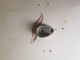

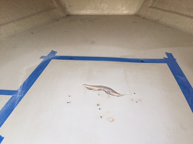

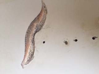

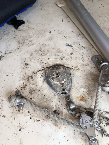

I have exactly the same identical crack in the same location in my 1982 DS2. Not sure how to fix it. I am learning from the back and forth recommendations. Has anyone shared the repair aftermath? Second thoughts? If I was to do it again...? Did the crack come back?
I was going to reinforce the cuddy floor (10"L x 12"W) at the mast step location, with fiberglass mat layered below heavy 24 ounce woven-glass, then gel coat paint the repair after sanding and a hot coat of poly resin.
Should I move the mast step plate forward?
Any recent feedback is welcomed.

1982 DS2 Mast step crack 2 Location where plate mounts. Other holes are for CB rigging.

Postby GreenLake » Tue Apr 28, 2020 4:23 pm
The crack is there (most likely) because the bottom of the mast is not supported correctly and puts a load on the cuddy floor that should not be there. There's a good chance the crack will come back if the support below the floor isn't fixed. There's no way an unsupported surface, even if reinforced, can take the full load of the rigging. It does need to be supported from below. It's possible that the damage comes from heavy gear stored in the cuddy flexing the floor where it is held fixed between lower support and mast. In that case reinforcing the floor might be sufficient.
If you are planning to use epoxy resin for the repair, be aware that you need epoxy-compatible mat (or simply use several layers of cloth).

Postby mtmckaig » Tue Apr 28, 2020 7:23 pm
Thanks GL,
No heavy gear is stored. Obviously I am not the original owner so who is to say.
Seems from what I have read the compression post is slightly forward of the mast stub plate location and over time the downward force in addition to sailing up wind into weather, has over stressed the floor, and has torn the fiberglass.

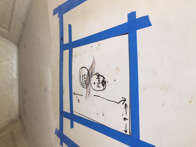

To make the repair I need to open up the floor. I am including a picture of where I am planning to cut. Any advisement would be gladly received.
If I cut the cuddy floor to add another strategically placed support post, is there substructure I should avoid cutting through?
Somewhere I read that there are two support channels but I can not remember the location of the information to reread it; and more specifically what the measurements and reference points are. I have two bilge access fittings but my camera work is not so good.
Also, guidance for material to make another post would be greatly appreciated. 2 in PVC Pipe?
Thanks
Mark
Access compression post area by cuttting inside inner blue taped off area. Install new support post under mast plate.

Postby GreenLake » Tue Apr 28, 2020 10:38 pm
You are correct, there is a support channel somehwere (I personally don't own a DSII, so my input is a bit second hand on this). Can you locate by knocking?
Where to cut? Suggest circular cut that can be covered with a deck plate. Always good to have an inspection port. I think aft of the mast plate, but check about that support - earlier posts here should tell you some of that, but you might be in for some patient reading.
Materials. Anything that promises to be as strong as the mast. PVC pipe, but diameter? The post required is so short, that you shouldn't get issues with buckling/bending, but the walls need to be strong enough to hold 400#. Sine you'll have cloth and resin, you could laminate one around a paper towel roll on your workbench, then cut to size. Something I would be tempted to do unless I had PVC pipe ready at hand. Definitely something to try if this is your first rodeo with glass & resin. Always good to practice on something that you can discard, and start over.

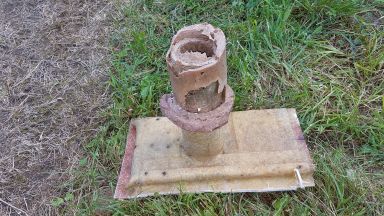

I cut a rectangle around the step in my cuddy floor for a different reason--the screws for the mast step (keel stepped) were stripped and it was loose. I was lucky enough to have the compression post well centered under the step. So I just added some epoxy coated plywood at the top of the post, 1.5" thick allow for future repair with longer screws. But a word of warning if you make these floor cuts: It might not be easy to keep the floor at it's original level. The floor is under stress and may have its own mind once freed in the center. I was worried mine sank too low so I propped it up before glassing my piece back in place. I ended up about 3/8" to 1/2" higher in the middle. As the old timers say, "You might wanna..." make some measurements or add some support before the floor is completely free from the post. I was not expecting this issue.
Pretty sure that filler in the post is gelcoat resin. Nothing stinks through a respirator when sanded like gelcoat. Luckily, my dinky original "turnbuckles" were able to take the extra height of the mast; I got more boom headroom; and she heads better than ever when I let go of the tiller. Phew!
