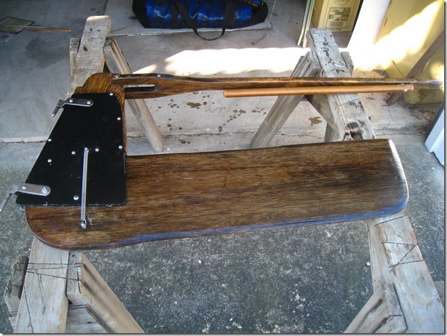

OK Tipster1, if you think removing the tiller is cheating, how about my rudder head modification.

Fantastic! Actually reminds me of the rudder head on my previous boat, an AMF Sunbird. It didn't sail as well as the DS, but it had some much improved designs, which I wish I could add to the DS. Nicest was a spring loaded system that was both a rudder lift and a rudder hold down. Two pins and two springs designed to either hold rudder down or pull it up when it deflected past a certain point. Principle is eassy, but I don't feel like drilling holes all over the place to experiment.

I have the pictures on Photobucket. I attach the thumbnail to my post. I made a new rudder head to allow the blade to come up out of the water for dealing with very shallow water when beaching my boat on the Texas coast.
