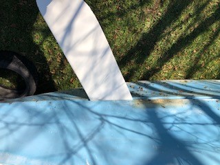

As a sidenote, it's fascinating to see the CB mechanism in action with the boat out of the water. Couple of observations:
1. My CB won't fully retract unless I give the uphaul a swift tug and keep tension on the uphaul. The extra momentum helps get the board fully up. Otherwise there's too much "stretch" in the system to fully raise the CB. I've gone to marking the uphaul with a piece of tape so I know when the CB is fully up.
2. Likewise at full extension the CB sits well past vertical. This can be seen in the below photo where it looks to be at least 20 degrees forward of vertical.
Fully extended CB is well past vertical
CB 2.jpg (44.39 KiB) Viewed 6876 times

I don't know whether there's a situation where you'd ever want the CB forward, so you might want to mark your downhaul...

Mine is vertical with about 2" of downhaul "capacity" left. I read somewhere that the forward position might work well for heading up light air, but I had to deep-google for that and I'm not really that curious. Though I might have to figure out whether to put tension on the uphaul as well to keep it vertical (?)

The forward position would put the CLP forward, which would tend to increase the weather helm (or compensate for the CE having moved forward). I can't quite see how this works in light air, so I'll note that as a question in the "Seamanship and boat handling" section, where we might get input from others.
