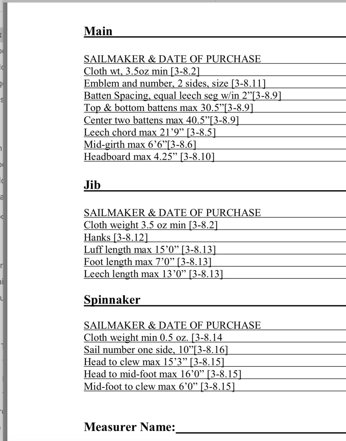

So I was looking at the Day Sailer Sail Inventory Measurement Certificate page of the DSA Measurement Certificate, looking for the "official" main, jib, & spinnaker sail measurements, and found the attached measurements which I captured with a screen shot.
Wanted to measure the sails I already own to see if they would meet DS rules.
Thought that Main sail would have a luff, foot, and leach measurement like the jib does; but don't see that here. Spinnaker measurements are pretty straight forward also. I don't really understand the measurement categories provided for the main sail. Going to have to look for a picture of those items and then try to sketch them out
Are there main sail measurements (luff, foot, leach) in addition to those listed on the certificate?

Postby GreenLake » Mon Oct 21, 2019 6:55 pm
Rob,
what you posted is just a form that the class measurer fills out (with enough reminders to be able to spot a measurement out of range). It does not give the actual definition of what is being measured, nor the measurement procedure. For that you need to consult the class bylaws on measurements.

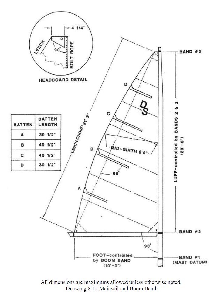

Here's a drawing from that document giving the dimensions for the main:
Drawing 8.1 from DS Class Bylaws

Postby RobH912 » Mon Oct 21, 2019 10:48 pm
GL - thanks for sending through the link to the class by laws on sail measurement which is exactly what I was looking for. Includes pictures... always helpful :D
Didn’t understand mast bands / measurements on the bands either, see that picture also.
Good info!
Re: sail measurements, please
Postby GreenLake » Mon Oct 21, 2019 11:01 pm
Bands: rather than defining the size of the cloth, the rules define how far you are allowed to stretch it along mast and boom, that is, it has to be kept inside the bands. By marking the bands, competitors can be assured that nobody uses a larger sail (if they did, it could not be stretched flat, which isn't fast).

If you and I were sitting around a table, or on a phone having a conversation on this topic it would have taken less than a minute to resolve, maybe two minutes. On an Internet forum questions and answers sometimes are hard to interpret in context or the questions / answers seem to take a life of their own... the answer was in the diagram you posted... Luff 20' 6", Leech Chord 21' 9", Foot 10'
