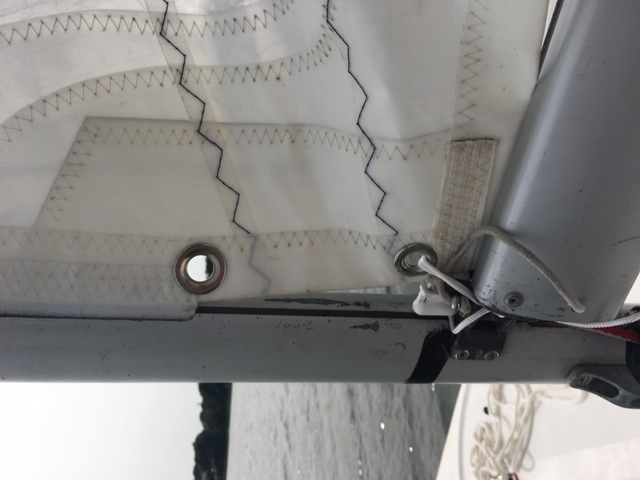

Postby rkennedy » Sun Jun 11, 2023 9:09 pm
I just bought new north sails for my DS II.
Before I put the sails on I measured for the top of my mast to the top of the transom, it was 24',11.5", what is suggested in the north tunning guide,
Took the sails out of the bag and put them on the boat.
There is no grommet in the tack of the mainsail. There is a slug at the tack. With the mainsail pulled to the top the slug ends up 6 to 7 inches below the boom insert slot.
I used the grommet that was 6 or 7 inches above the boom to secure it to the boom.
But then I also had a issues with the outhaul, I had to pull it all the way to the end of the boom just to get it snug? The only adjustment I could maker would be to make it looser.
I sailed in my beer can race today but was really annoyed that I could not make any adjustments to the mainsail.
With the new mainsail on the boom is 6 inches lower that with the old Niel Pryde sails?
Has anyone else had this experience with North Sails?

Postby GreenLake » Mon Jun 12, 2023 3:43 am
First of all, let's make sure you have full hoist of your sail. Just to rule out that for some reason the new head doesn't get raised as high as for the old sails. (From your measurements, we already know that your mast is the correct length). I've had it happen with new sails that the way I connected the halyard prevented a full hoist because the location of the headboard grommet had shifted.
Next, the boom should sit at about 24'' above deck. Is that what you see? Or do you see 6" inches less? (For a total of 18") (If the latter, and you have full hoist to the top, something's wrong with your sail).
The missing grommet may be intentional. If the slug ends up close to the boom, it would be well placed to counteract the pull from the outhaul. Meaning, if you tighten the outhaul with the slug in the mast track, then the corner of the sail should not move backwards. If it does, something seems wrong.
Now, with a slug, you don't get the connection to the boom as you had noticed. However, with a DaySailer, there should be a boltrope in the foot of the main and that is required to be used under class rules. And by using the Cunningham (the grommet that is 6-7" above the boom) you can set the luff tension as needed to get the wrinkles out from next to the mast. With the Cunningham under any tension (even light tension) the tack no longer needs to be pulled down. So I imagine the sailmaker thought that it was redundant. You can always put one in, if it makes you happier.
The maximum distance the clew can be set from the mast under class rules is 10'. The foot of you sail should not reach that width unless the outhaul is tight. (The slug will have to be in the mast track below the boom gate). If your sail reaches the full width without any tension on the outhaul, and you confirm that it is 10', then something may be wrong with your sail.
I hope the helps answer your question.

Postby rkennedy » Mon Jun 12, 2023 9:04 am
>First of all, let's make sure you have full hoist of your sail. Just to rule out that for some reason the new head doesn't get raised as high as for the old sails. (From your measurements, we already know that your mast is the correct l>ength). I've had it happen with new sails that the way I connected the halyard prevented a full hoist because the location of the headboard grommet had shifted.
It was right at the top, but just to be sure I am going to put the main back on and take some pictures.
The boom was head banging level. I did not pull the vang on because it was already to low.
>The missing grommet may be intentional. If the slug ends up close to the boom, it would be well placed to counteract the pull from the outhaul. Meaning, if you tighten the outhaul with the slug in the mast track, then the corner of the sail should not move >backwards. If it does, something seems wrong.
You are right GreenLake the missing Grommet is intentional. The rep from north sails got back to me. The tack slug relies on outhaul pressure to keep the sail and bolt rope from moving up and out of the slot.
>Now, with a slug, you don't get the connection to the boom as you had noticed. However, with a DaySailer, there should be a boltrope in the foot of the main and that is required to be used under class rules. And by using the Cunningham (the grommet that >is 6-7" above the boom) you can set the luff tension as needed to get the wrinkles out from next to the mast. With the Cunningham under any tension (even light tension) the tack no longer needs to be pulled down. So I imagine the sailmaker thought that it >was redundant. You can always put one in, if it makes you happier.
Right again GreenLake, I had tied the grommet off around the mast because I did not understand the function of the tack slug. I will reconnect the cunningham to the first grommet.
I have to fiigure out if I truly did have the main raised all the way to the top, I had my son walk back on the dock and look at it. He said that it looked like it was right at the top.
The other thing I need to look into is why the clew went all the way to the end of the boom, I could loosen the outhaul but I could not make it any tighter. Even if the pre-bend was wrong in the mast the bolt rope in the mast and the boom length should make that length the same
I hope the helps answer your question.[/quote]

Postby GreenLake » Mon Jun 12, 2023 6:52 pm
OK, pictures would settle this.
That's not a precise measurement :D , but it sounds like it was below the nominal 24". If the luff of your new sail is longer than 20' 6", that would be a problem, because under class rules the sail may only cover 20' 6" of the mast track. The vang normally pulls the boom level, when there's wind in the sail, and doesn't usually make it point down (or if so, just a bit).
OK, because of the slug I had assumed this sail does not have a boltrope along the luff (mast side) but only in the foot (boom side), however it see it has both ropes, and only a solitary slug? Makes little difference for the rest of the discussion other than that bolt-ropes in the mast can hang up below full hoist in ways that an all slugs sail would be unlikely to.
Great.
I have to figure out if I truly did have the main raised all the way to the top, I had my son walk back on the dock and look at it. He said that it looked like it was right at the top.
OK, we are waiting on pictures for that. 6" of missing hoist should be easy to spot, but 2-3" may not be as apparent to anyone who isn't experienced.
You are right, there's nothing related to pre-bend here. You could lay your sail flat (perhaps with gentle pull from your helper) and measure from the inside of the slug to the end of the foot (that is to the aft edge of the sail, or leech, at the position of the clew). That distance should not be more than 10'. In fact, you would want that a bit less, so you can apply positive outhaul tension.
However, it's a used boat, so you need to confirm that the boom is still long enough to hoist a 10' wide sail (measured from the aft end of the mast). There should be 2-3" (at least) beyond the 10' mark, so there's room to fit the outhaul.
The DSA bylaws require racers to put a tape (band) at the level of the deck, another one at 24" above that (nominal level of the boom) and another one at 20' 6" above the second one. (And a fourth at 10" from the mast around the end of the boom). Electrical tape works well for that.
While you may not plan to race, these "bands" are easy to apply and would give you direct feedback as to whether your new sail fits inside the maximal allowed dimensions. Because there's no reason to go outside these dimensions (after all, the boat was designed to them) any sail that can't be hoisted within these bands, but marketed for the DS would be returnable as "not fit for purpose".
Also, by marking your mast and boom, you would be assured that they indeed are the original design length. If you find any inconsistencies there, it would mean that you would need to order custom sails as your boat would be non-conforming.
Please note that the NS tuning guide does not need to make reference to these bands, because they are part of the class rules and all their racing customers would of course have them applied as specified.

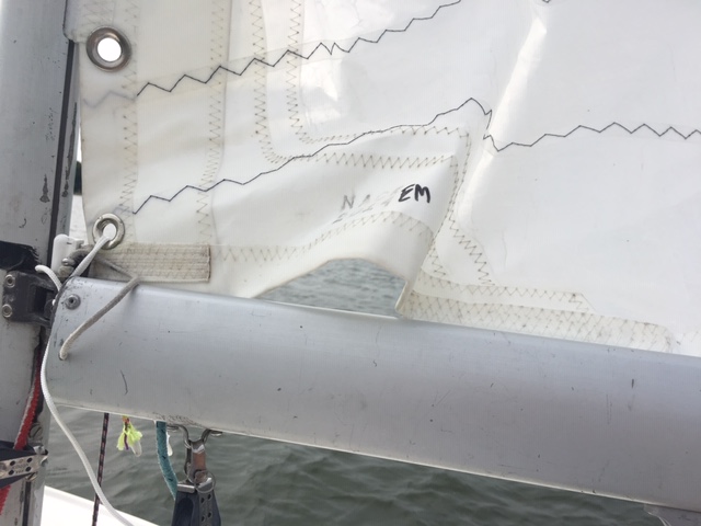

Re: Goose Neck Question... from a newbie
Postby rkennedy » Mon Jun 19, 2023 1:29 pm
I put the sail back on yesterday, (sorry forgot to take pictures) and showed the problem to another daysailer at the club.
After a minute of looking at it he said you know my boom doesn't go that low, it can't go that low because I have stoppers in the bolt rope slot that prevent the boom from going any lower.
So we released the down haul and lifted the boom about 6 inches, then I tied the boom off to the 1st grommet, lightly secured the down haul and everything looks correct.
I order a 1/2" sailstop from amazon. It should fit in the bolt rope slot of the mast. I will slide it in before I put the boom on and then lock it in when the sail looks good.
There is still not much adjustment in the outhaul, maybe another inch of two once the sail looks good. This may be that I have not raised the boom to the proper height?
But even with the current set up I should be fine for most of the conditions that I sail in.
Postby GreenLake » Mon Jun 19, 2023 6:08 pm
I'm still a bit confused as to what you are doing. What is the position of your boom stop above the deck? (You say the new one will be 2" higher, but that doesn't tell me how high your boom will end up when you are done).
When I raise my main, the boom downhaul is off. (As is the vang). When the main is fully hoisted, the boom sits above the stopper by a few inches. I then pull the boom down and tie off the downhaul. That adds a bit of tension to the luff.
My stopper is at the regulation 24" above the deck, not lower.
I find that if I fix the boom first, I cannot fully hoist the main. (It's too hard to both lift the sail, and add tension). That's why I needed to switch to the sequence of operations as listed above.
Postby rkennedy » Tue Jun 20, 2023 5:04 pm
THe boom stop, is missing, (aka sail stop). The weight of the boom are pulling the sail past where is should have been.
Is your stopper a thumb wheel with a tube that gets inserted into the bolt rope slot?
THe older Niel Pryde sail that came with the boat had the grommet in the tack. With the sail fully hoisted this would set the boon hight by default.
With the tack slug on the new sail the weight of the boom can cause the sail to pivot so the clew end rises and the tack sinks. The goose neck binds a
little in this position and I had to tap up on the bottom of the boom by the tack to set it at the right height.
I talked with Rudy and the sail-stop insert did not come standard with the original mast. But he has them in stock.
Postby GreenLake » Wed Jun 21, 2023 3:13 am
I have a stop and a cleat. I think they are different parts, both fixed in the boom slots but tightened with normal screws, not thumb screws.
My sail keeps the boom above nominal height, and I need to pull it down to the stop with the downhaul.
