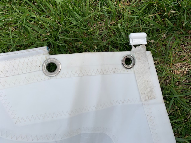

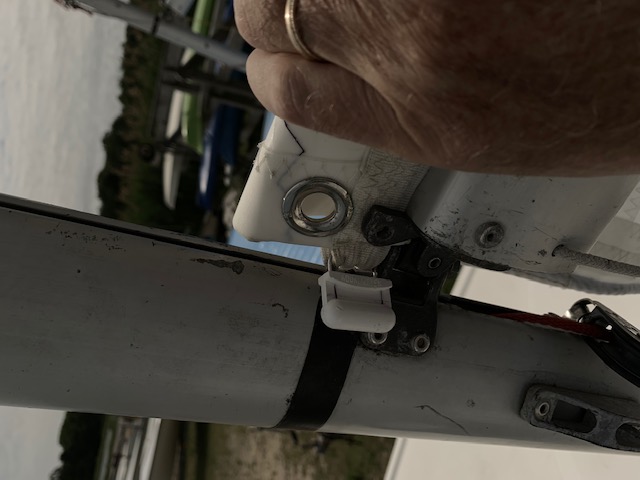

In my earlier part of my post I also tried to describe the connector pin / sail tack grommet issue I was having.
Have attached a couple of pictures showing how the foot of the sail sits too high in the boom track to allow me to insert the connector pin through the grommet, and the work around I am using by inserting the connector pin behind the "plastic car/guide" sewn on the sail below the grommet. There is no place for the car to go, but the connector pin does fit behind it / tack seems secure. Not sure if this set up is sub-optimal and a cause of boom not staying on the gooseneck pin, even if I really pull out the outhaul.
Going to try to sail Wednesday and although light winds are forecasted I'll tighten up the outhaul and boom vang to see if I am to pull the boom out from the mast.
Any thoughts, pictures always appreciated.

Not quite able to see this from your pictures, but something is holding the sail in the boom track, correct? Bolt rope? Not sure that is up to the task of holding the tack down. You may need to use a lashing thorough the lower of the two grommets and around the boom to take the luff tension (until you apply the Cunningham, that is). Some thin stuff, wrapped a few times and tied off with a square knot. You don't need that super tight, just so it takes load when tension goes on the sail.
The slider car you show in the pictures is intended to take the fore/aft tension at the foot of the sail; it has to be in the mast track for that, of course. If you tighten your outhaul, even moderately, the boom should not be able to move backwards; but that only works if the front of the sail is held close to the mast by the slider.
Tightening a vang will help as well, but there are conditions where you want either control somewhat loose. If you experienced the boom escaping in stronger winds, that's when you would most likely have both outhaul and vang tight.
What kind of vang do you have? is it a high purchase one (better than 10:1?) In that case, the PO sailed his boat using vang sheeting, where the vang is tight even upwind. The good news is that the type of gooseneck you show is really sturdy and probably well suited to vang sheeting. If your vang isn't set up for that, you may be able to upgrade.

Yes foot of the main sail has bolt rope that fits in a slot on the boom. I think the tie tack down through the cringle is a good idea. And why not also just add the pin behind the plastic car like I have been doing also ? The car would have gone into the feeder slot which is now u under the goose neck... the main sheet halyard exits out of the feeder slot. I had posted pictures of that on my halyard questions post.
