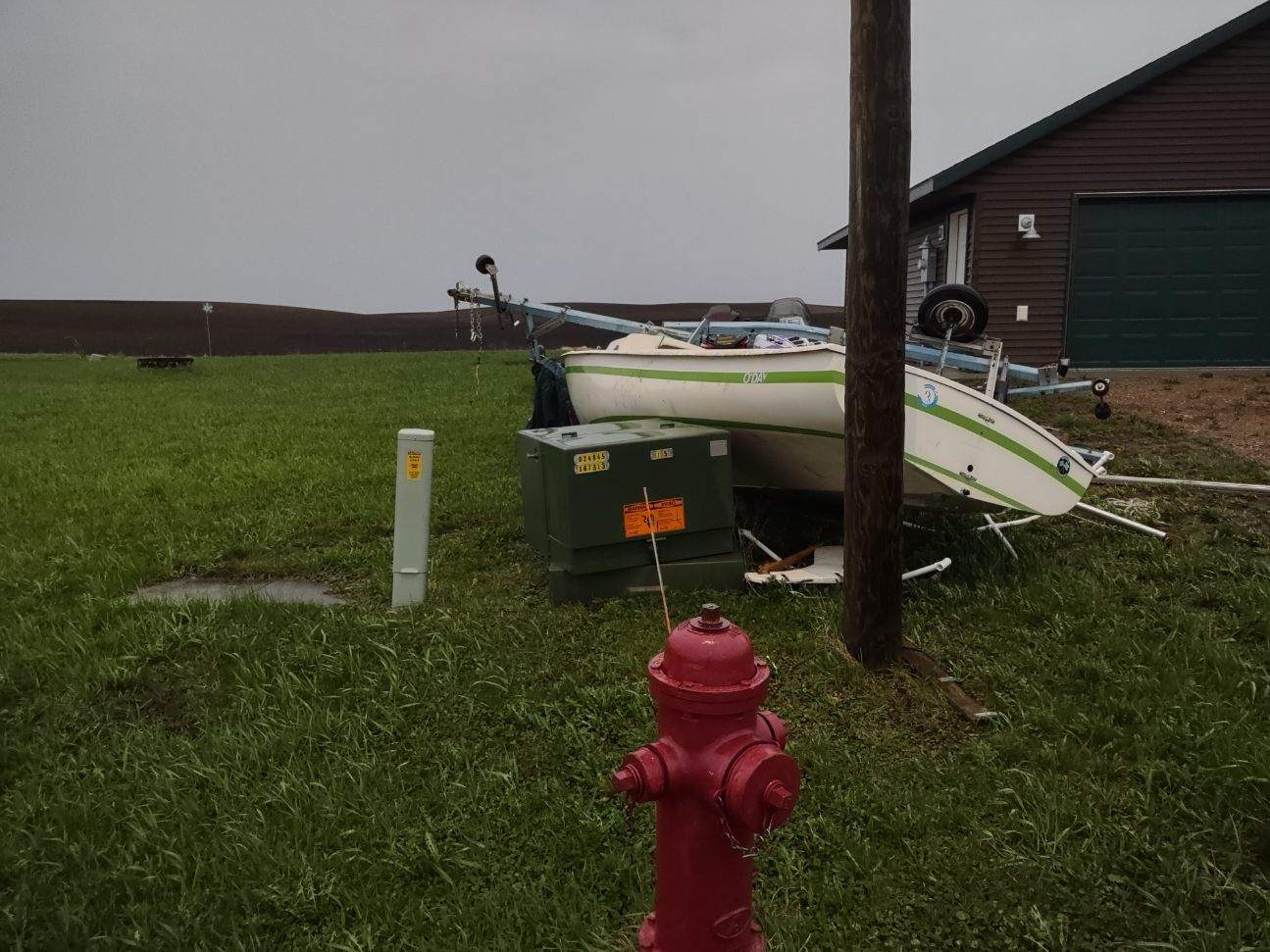

Postby bilbo » Tue Sep 06, 2022 7:09 pm
My boat was damaged in a storm early this year. Then I moved across the country and am finally getting time to fix the things that were broken. The boat and trailer was picked up by the wind and smacked into an electric utility box. The damage was some scrapes, broken bow eye (that was loose already), some dings on the rub rail, broken spreaders, and two big gouges on the bottom where it hit the electrical box. All things considered it didn’t fair too bad. Unfortunately the gouges on the bottom are leaking water. I filled the bilge with water and it was coming out at about a drop every three seconds.
Can I repair these from the outside? It would be easy to careen the boat and grind out the damaged areas. If needed, I can add glass cloth and resin. Would epoxy be ok or should I use something different? I can get some supplies locally but I believe it is polyester based. Any special considerations for either resin system?
