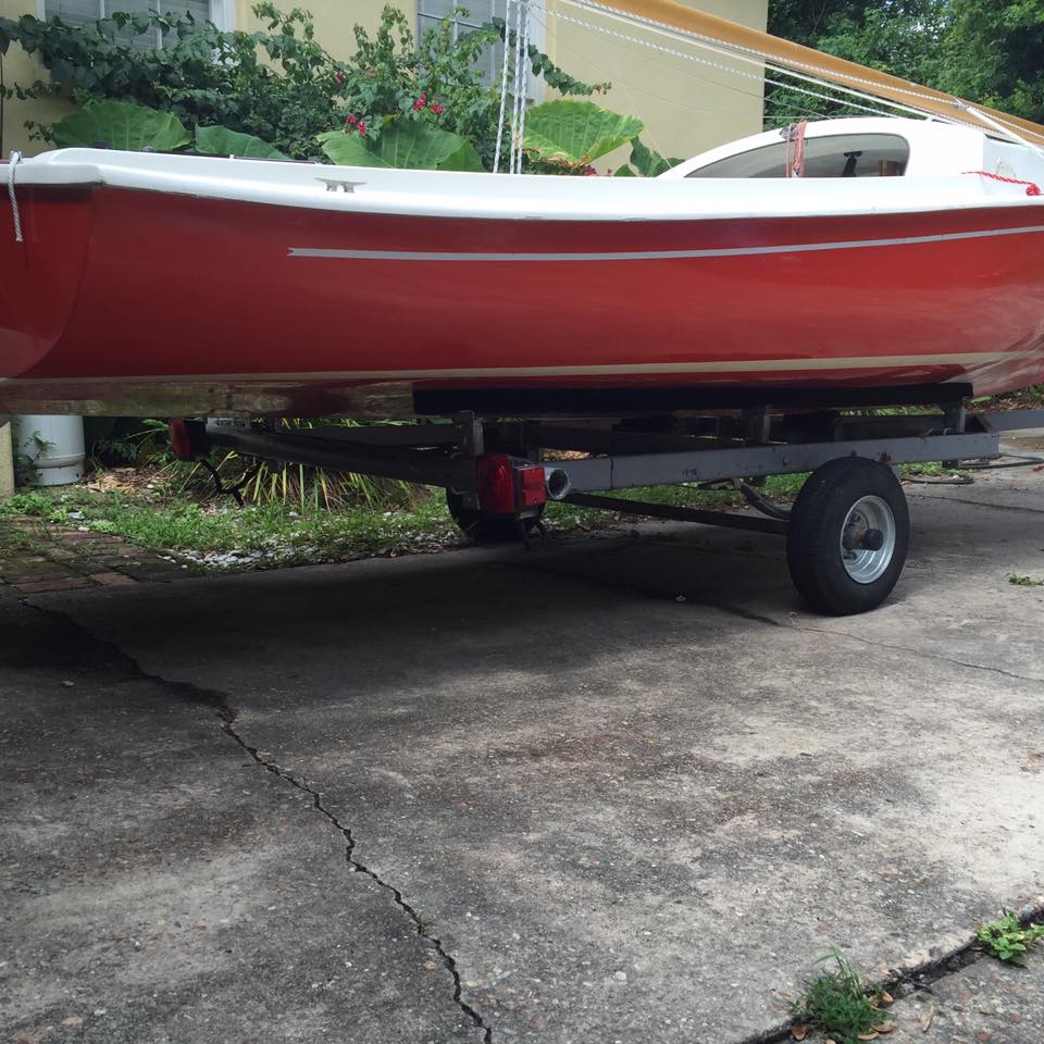

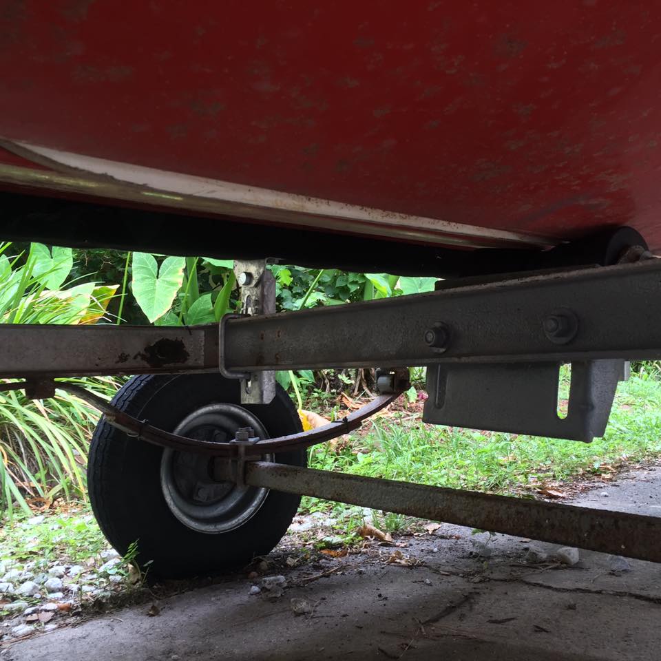

If you need ideas... I just did a trailer project the other weekend. Had a similar problem. In the picture I added below, you will see the green carpeted bunk, and the way it was fixed to the trailer essentially left the boat resting on the corner of the bunk (Not good). There were other problems with the way the original bunks were attached to the trailer, but I won't get into that. So, what I did to get the angle of the bunk to spread the load a little better is use swivel bolsters that rock from side to side. The boat seems much happier at rest now.
Parts here... http://www.easternmarine.com/8-galvanized-bunk-bolster-bracket-kit-81210
I used the 8" one to keep the boat low on the trailer. I think the cost was around $50 for all 6 that I used.
I still have more work to do. I plan on putting on either 2x6 or 2x8 bunks that are much longer (I think the black ones I have on there now are only 7ft). When looking under the boat, it definitely wants the bunks to come all the way back to the transom. You can see a very small bit of flex at the edge of the bunk as it stops about 2.5 ft from the transom. None the less, what I have now is far better than what I started with.
As for where to put the weight of the boat (bunks or center line), I think that you will get a different answer each time you ask. I choose to distribute it between the rollers and the bunks on my trailer. I happen to have 6 bolsters (probably way overkill), but that allows me to loosen the middle ones with the boat on the trailer, and let it sink a little bit. This allows it to rest a little on the rollers, and curve the bunks a little to conform better to the shape of the hull. Not sure if this is right, but what I did and so far so good ;)
And yes, working on a trailer at the ramp in the rain... was not as fun as I thought it was going to be, lol.
As for the centerboard, mine folds all the way up into the trunk, so no issues with it being compressed between the boat and a roller. GL, am I deciphering from what you are saying that some boats it is possible for the centerboard to stick out of the trunk a little when completely retracted?

As it now sits on the trailer, the aft end of my boat's CB extends about 4" proud of the hull.
Yep, mine folds all the way up into the trunk. Not sure if that is normal or not. Maybe someone with more experience with these boats will chime in. Seems like it should retract more to me.
I may be able to add a keel roller forward of the rear keel roller, to support the aft end of the CB. Any good ideas on how to add a keel roller bracket to the open side of the trailer's cross-member C-beam? The existing bracket is bolted to the face of the C-beam.
I have 2 rollers, one forward of the CB, the other is under the CB. Once on the trailer, I just drop the CB onto the roller. I tried to take a picture, but not sure I got a good one. There are 2 holes driller through the crossmember for the bolts to attach it. The rollers can be adjusted up or down by sliding them with the bolts loosened.

I did not make them. They were pre-made. I bought the boat about a year ago, and there were a million projects that I have done with it. Those bunks were sitting around for a while. I knew from the "get go" that I needed to do something with the trailer, but there were lots of other things that impeded sailing that got shifted in front of trailer work. Then one of the bunks started to break loose, so I had to do something sooner than later and the pre-made bunks got used. Now that I know a little more about the boat, I think I will make some bunks in the near future. I am pretty confident that there is beneficial support to them being wider than 4". I am curious too about the best type of wood, etc to use.
Do the bunks, when oriented with their wide face against the hull, conform to the hull shape as a result of being wet and put under the stress of the hull's weight?
Yes. It is much better. Before when they were upright, there was no bend at all and not only did the boat sit on the corners of the bunk, much less of the hull touched the bunks. Now nearly the entire 7ft of bunk it touching the hull (except that little bit of bunk towards the front). I am sure more support (to the transom) would be appreciated by this old boat, but considering what I started with it has to be much happier.
