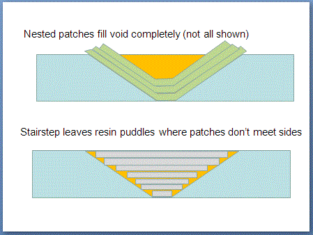

I believe you are supposed to put the fiberglass patches in smallest to largest, opposite of the diagram you drew. I’m not an expert but i’ve been doing quite a bit of research because I am getting ready to begin major repairs of my boat as well. I found a guy online who makes videos about how to do boat repairs, he is great and I have seen him recommended numerous places online. I will attach the link for his video on fiberglass repairs below.

Nickc, that's what I thought too. Andy has a video for "one sided repairs" and he lays up his plies as you said. I've got some more grinding and prep to do, so I've got some more time for research before I get to that point, but the more I think about it if the large patch goes in first it might bunch up, no? Especially where the layup is thicker. Maybe not, I don't really know. This will be my first go at layup since I was in school 12 years ago, but that was a lab so very different.

I'm basing my recommendation on materials published by two different vendors of epoxy resins. While I think they are reputable sources for this information, I couldn't help wondering about a possible reason for this counter-intuitive approach.
Best I can figure out is that you avoid "stair steps" inside the repair if you go largest first. These little steps create places where there's a bit of unreinforced resin, which weakens the laminate. On the other hand, going largest first, all the "steps" are at the surface where you'll sand them smooth, and as long as the repair is shallow enough to allow the laminate to conform, there's no space that isn't filled completely with glass.
Also, if you go smallest first, you have to be perfect in sizing your patches, while in the largest first method, any excess is sanded off at the end, so you only need to make sure you do have a bit of excess, but don't care whether it's exact.
Different ways of stacking laminate to fill a shallow repair
What I can't answer is whether the difference reflects a level of theoretical perfection that isn't noticeable in practice, or whether it matters. I suspect the answer to that will depend on whether the laminate being repaired is overdimensioned for the loads it experiences. The closer it is to minimal required strength, the less infidelity in repair you would be able to tolerate. Some part of the DS hull are truly overbuilt, but the flat sections of the rear hull may experience forces that are closer to the design limit.
I have nothing riding on how either of you does this, but I felt like sharing my personal level of understanding on this issue. So, now you have all the info to make your own decision.

bilbo wrote:Still undecided on the order of my layup. I've been doing research and there are compelling arguments both ways. I may end up flipping a coin.
As I wrote, I have noting riding on whichever decision you make. However, I always like to learn and find out whether a piece of information is just something that is endlessly repeated by one source cribbing from another or whether it represents a better understanding of an issue.
In this case, the more detailed and comprehensive written guides (not videos) that I've consulted have the large-patch-first method, while I found many of the more basic guides advocating the "obvious" small-patch-first solution. In some cases, I had other issues with the info presented by those basic guides, and they gave no reason for their approach.
When I wrote my earlier post I had forgotten the actual reasoning given for the large-patch-first method and came up with one of my own. Because your remark made me curious, I went back and looked at one of the sources and they suggest that sanding the patch may work differently. If you see my graphic above, you'll notice that sanding would mostly cut through the edges of each layer in the largest-patch-first method. However, in the smallest-patch-first you are effectively sanding only the top layer, and if that's not flat, you'd sand through that. Now you've reduced the strength of your largest patch. Anyway, something like that.
As much as I love to chase such things down, it may well be the case that once you've finished your repair, that particular choice isn't as much a contributor to success as many other things: incorrectly mixed epoxy, insufficient dewaxing of the repair site, puddling of liquid epoxy, or conversely starving the repair and not fully wetting out the laminate. So yeah. But I'm still curious about what other rationales are being claimed pro and con. :)

So far I've not found any "official" publication other than one from West System that details the order of layup, and it says start with big patch. Lots of internet expert opinions though.

bilbo wrote:So far I've not found any "official" publication other than one from West System that details the order of layup, and it says start with big patch. Lots of internet expert opinions though.
I was under the impression I had found that in other places when I first researched it many years ago. But I can now also only find it at West. However, it's hard to think of a more reputable source. If I had the proper tools for destructive testing, I would for sure want to try for a head-to-head test.
BTW, I thought of another reason why biggest first can be useful: it would be best at spanning gaps in any situation where you don't have a backing plate. But by the time you ave a gap big enough for that to matter, you might be using a baking plate anyway...

The longer I stare at this diagram, the more I'm convinced it's the difference between gluing/laminating flat surface on flat surface vs. "edge on".
The first joint, for the largest patch, would be a glue joint without chemical bonds, while the next layers are all part of a single laminate. If you go big first, the glue joint is nice and continuous throughout without any gaps and transitions. That should give you the best conditions for what is the weakest part of your repair.

On the theory question. I finally found a discussion where this very same question is addressed. The rationale, as I suspected, is that you want to get the discontinuities out of the repair. Which matters most if you have limited design reserve. Luckily for us, the DS was overbuilt and so is more forgiving.
Here's the link to the discussion.
One of the other nearby posts in that thread shows a diagram that illustrates the discontinuities with the smallest-first approach.
