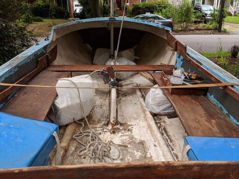

On the other hand, I need to figure out the side "tanks." Here's the cockpit, welcome aboard, mind the mess, don't sit on anything:
Cockpit
Except for the coaming and that drawer(*), all the wood is rotted and is going to be replaced. While I'm at it, I want to secure the flotation in the side-tanks (behind the vertical blue/grey side bulkheads). I'm pretty sure there is foam in there because I stuck a screwdriver down a larger hole and pushed SOMETHING that made a foam-like shifting-sliding sound. This area is definitely a candidate for pool noodles. How to do it? I'm thinking of cutting two inspection ports (fore and aft) on each side above the line of the seats, digging out all the foam I can then replacing with pool noodles and then putting on inspection screw-hatches (maybe even leave a small area behind the plates for waterproof storage, using a round plastic food tub). Any other ideas on how to do this? The side "tanks" are walled off forward with a tiny bulkhead, maybe 4 inches wide, I dont think it's worth trying to access the area thru there at all. But what about leaving the foam as is? If I can pull out a sample and again, test somehow...?
Lastly, the aft "tank" is a 18 inch by 6 foot area under the aft deck with an access hatch and an utterly not-waterproof plate. It was filled with junky foam bits that I already took out and tossed (those white garbage bags). Newer than the stuff in the forepeak, because it had the large "grains" of modern styrofoam. It was mildewed to all hell, just pure junk. I'm thinking of putting dinghy-style float bags right under the deck (top half of the tank) and opening up the bulkhead at the bottom, from side to side like the 60's-style DS-1's so that I have a bit of storage for fenders, etc. I have some calculatin' to do before I go that route (make sure I have enough foam+bags for positive flotation), but my rough estimate it that I'll be OK. After all, that area has no flotation at ALL in newer DS's, and I have more flotation in the side tanks and forepeak than the newer boats (and it's up high = less chance of turtling). Yes, I'll be stuffing noodles in the mast as well.
Any thoughts, comments, warnings, or facepalms would be appreciated!
*Yes, old No. 37 comes with a drawer - slides underneath the port bench on little rails, has a locking drawer-handle to keep it from falling out, and has holes in the bottom to drain water. Definitely going to include it in my bench rebuild, a handy place to put my boarding axes, pistols, and small cannon shot...

Postby GreenLake » Mon Aug 20, 2018 5:54 am
The forward foam seems fine. It looks like they either were experimenting how to to it, or it may have been aftermarket, but that's hard to know. In any case it's not enclosed, which allows any water to evaporate. For replacement foam, pool noodles work well if you have to insert them through an inspection port, but you want to make sure that any tanks are well sealed as the noodles have enough interstices to allow significant amounts of water. They should best be seen not as primary flotation, but as back-up.
If you drill a hole near the bottom of the side tanks and stick your finger in, you should be able to tell whether the foam is waterlogged. And you might gently (!) pressure test these tanks to see whether they are tight.
For the foam under the transom. Modern builder's foam, the blue or pink styrofoam should be good. I don't think that stuff gets waterlogged. Not sure whether there's a difference between pink and blue. I would keep it out of the UV, if necessary you can (spray-) paint it. You can cut it to size with a fine saw or a hot wire and you can get a much better fit and fill than with pool noodles.

PS. Thanks for the tip on the builders foam, perfect solution for my aft flotation, no pesky bags needed. In meantime, I'll cut a pinky-sized hole in the side tanks and feel around. If that foam is good, I'll leave it alone.
