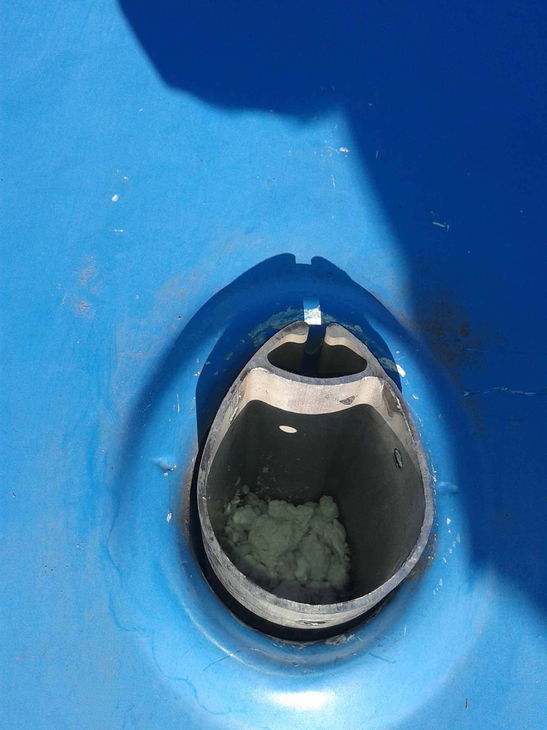

Greetings everyone! I am new to the forum and a new owner of a DS1. I recently raised the mast for the first time. The day after, we had high winds and while docked, one of my clevis pins failed, causing the mast to fall. When this happen, the tabernacle plate that is attached to the boat/cuddy ripped clean off, busting off all rivets that connected it to the boat/lower mast.

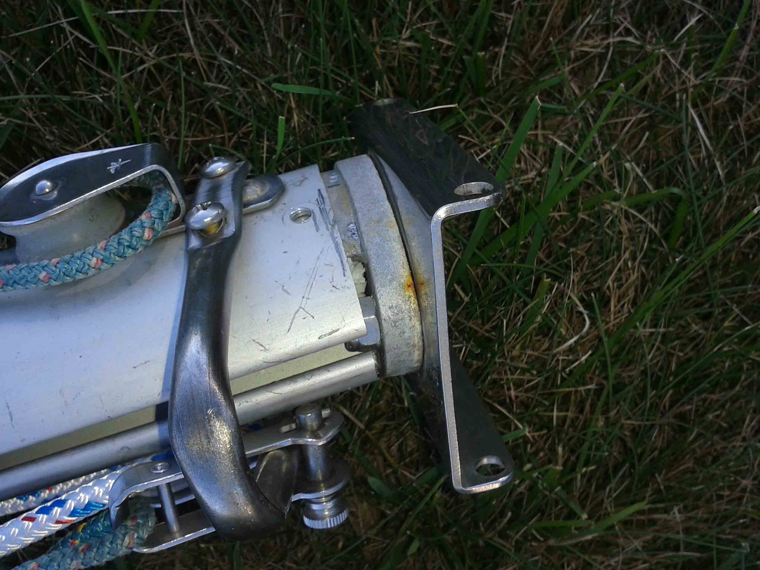

In addition, the tabernacle plate that connects to the mast itself is still connected, but it looks like it lost one of its rivets/pins during the fall as well, and now must be replaced.
I have attached photos.

mast still has 2 of 3 pins/rivets attached
1 rivet pin is still in place
tabernacle from cuddy-2.jpg (182.71 KiB) Viewed 6483 times
where tabernacle used to be attached

darts wrote:In addition, the tabernacle plate that connects to the mast itself is still connected, but it looks like it lost one of its rivets/pins during the fall as well, and now must be replaced.
From your story it is no clear whether the tabernacle itself is damaged (e.g. bent) or simply had the rivet shear off.
If you bend / twist a tabernacle hinge, you can get a new one from DR Marine (google for contact). They stock DaySailer-specific parts.

What is the best way to remove a rivet? Any advice anyone? As you can see in the photo, the mast foot/plate is now crooked because one of the three rivets that connect it to the mast has busted off in the fall. I am unable to straighten the mast foot because of this, so I am thinking I must remove the remaining rivets, in order to remove the mast foot from the mast and straighten it out, then re-revit to the mast...is this correct??
