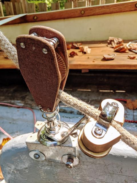

Postby tomodda » Tue Jul 30, 2019 12:19 pm
Just showing off today:
New/Old Jammer
I've replaced the ugly, old, falling apart and constantly getting stuck mainsheet jammer (block and swivel cam) with a "custom-made" jammer. I took my original Lewmar Ratchet Block (made of Tufnol, very old-school) and mounted it on a FICO swivel that I found on ebay, it's more or less from the time this boat was built, late 50's, early 60's. I had a beautiful (in my opinion) bronze cam cleat leftover from re-rigging the jib sheets. It was hidden under layers of old brown varnish, I was amazed at what I found once I put a wirebrush to it. So I machined a plate to attach old cam to new/old swivel arm, grabbed some nuts and bolts and voila! a 1958-style jammer for my 1958 DaySailer. Yes, I know it won't make the boat go one snail's shake of the tail faster, but it looks nice and makes me happy. Isn't that why we sail?
Re: #37
Postby GreenLake » Tue Jul 30, 2019 12:27 pm
Nice.
