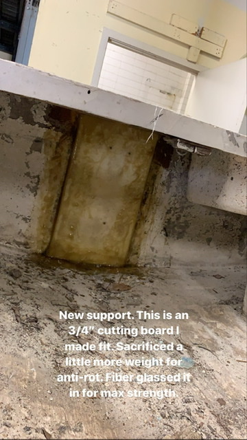

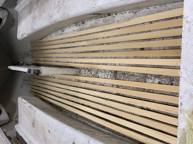

A little bit of progress yesterday, got the old rotted transom support removed and glassed in a new one. I had a 3/4” thick cutting board that was too far gone so I decided to use that. It’s a thick plastic material and isn’t too much heavier than a similar piece of wood and won’t rot. Also very dense and rigid. Also ended up glassing a few problem areas around the hull. Got the yellow cedar milled up as well and am slowly planning out a new floor. Hopefully today I will be able to sand down the exterior of the boat and prep for paint.

Postby igotit » Tue Jul 07, 2020 9:06 pm
Cutting boards are usually white teflon,not sure about epoxy....but i know fiberglass doesnt adhere to teflon,peels away easily.
But assuming once bolted up,should be fine encased in glass.but again if it is teflon,glass wont bond to it.
Nice floor by the way,i love working with ceder

Postby GreenLake » Tue Jul 07, 2020 9:25 pm
Nick, Cutting boards are usually not Teflon but HDPE (high density polyethylene). The downside of HDPE is that it's chemically not that different from wax - so, like Teflon, nothing sticks to it. However, for the transom support it basically acts as a backing plate distributing the rudder loads. If glassed in well, should work for that purpose, as you mention.

Postby Brianl289 » Tue Jul 07, 2020 9:43 pm
Yes good point about the adhesion. I did sand it with 80 grit first to hopefully add some texture to bond but more importantly it’s glassed in all along the edges and then will be bolted it with few different fasteners for the rudder and drain plug.

Postby igotit » Tue Jul 07, 2020 10:08 pm
I agree....encased in glass and bolted,shouldnt be an issue.i was just putting out some info that glass dosent adhere to teflon,and hdpe.
I considered mentioning hdpe,but wasnt sure thick cutting boards were hdpe.
My kayaks are hdpe,nothing sticks to it,not even 5200 after sanding.

Re: New member with project DS1, hello! (A restoration threa
Postby GreenLake » Tue Jul 07, 2020 11:15 pm
Yep, just like that.
