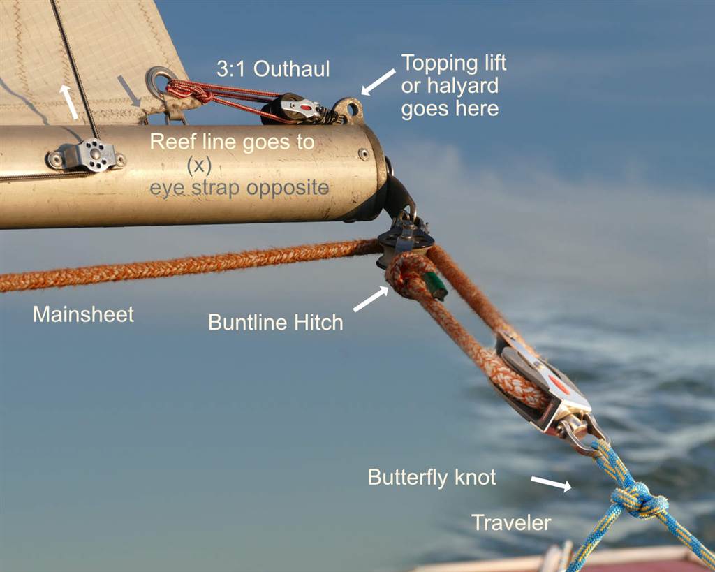

Ok, l found a boom for my DS1. The length is correct but does not have any hardware other than gooseneck. The aft end has the "tang" with a hole. What blocks do I need and how is the aft boom rigged. I read the original blocks are 57mm but they are huge . I believe I have a mainsheet with an eye strap on one end. How does that work? Any pics of original setup. I have searched forum for direction but can't seem to find the original set up.

Here's a side view of the boom for a typical end-boom mainsheet.
End-boom main sheet, side view

For the block in the back, you need one with a "becket". There are two ways to rig the triangle at the back; either you go with just the main sheet, and lead the end so it goes through the two transom blocks and comes back to the becket. Or you make a separate traveler (a loop of rope that gets pulled into a triangle shape). That one gets a single block tied into it and you run your sheet as a 2:1 purchase between that block end the end of the boom. Again, the sheet would end at the becket.
That's the setup I have, and it works fine with 40mm blocks. I think one of them may be even smaller by a bit, (hard to tell, the photo is a composite).
Rigging at the end of boom
The two ends of the traveler are tied together in a knot that has a loop sticking out of it, which I hook over a hook on the transom, so that I can "fix" the location of where the traveler block sits when going up wind. (All "stolen" from a rigging guide that's posted for members of the DSA on the member site https://daysailer.org).
