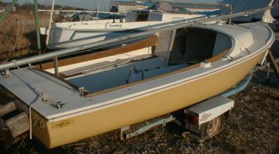

Two boats come to mind that could be mistaken for a DS I are the American 16 (15'-10" LOA) and the Discoverer 18 (about 18' LOA) that were made by the American Fiberglass Company (AFC) in the early 70's. The description of the compression post, the "pseudo wood grain" on the seats and no covers inside the cuddy cabin remind me of an American 16 I owned at one time. Attached are a couple pictures of these two Day Sailer "knock off" boats. The one with the red hull was the A16 I owned before I got my DS II, the other is a D18. My A16 never was restored and is a bit dirty. I found my DS II before I did work on it.
Does it have a double hull? The A16 and D18 did, an early DS I does not.
American 16
Discoverer 18 (American 18)

Both of the knock-offs shown look like they would present similar issues in making a decision (and most of the discussion might apply). One big difference is that neither could be sailed competitively - except in those places that have "mixed" fleets.
